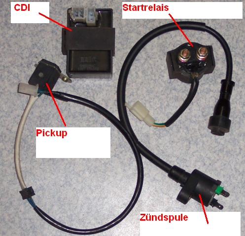

Hi Kurbis,
hier nochmal ein Bild von allen Teilen die Du bekommen kannst. Rest siehe PN
xt 250 gk2 springt nicht an.

Re: xt 250 gk2 springt nicht an.
Hi Nixi,,
No it is not working....... no calls..... I have had little time..... hopefully I will have time this weekend...... Since the new parts did not work I guess I will have to check the entire wiring..... I will send you a photo if you give me your normal emal address....... I beleive the cable baum was at some point defekt and a previous owner pieced it all together...... I must say I am stumped and will have to start with the wiring and then the ignition and I willl have to see exactly what the pickup does and if that could be the problem...... If you happen to think of something else to check let me know... Again Thanks for your help..
Hi kurbis,
the mail adress... nx99092 ät web.de.
Dont forget, check the ground connections from the engine.
Regards Nixi
Regards Nixi
